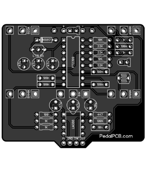

Adam (verified owner) –
Great layout and a fun creative tool.
Jonathan (verified owner) –
Super easy to put together, sounds fantastic. I only wish they’d included options or instructions for mods like the fuzz lift and lfo.
aaronsoave (verified owner) –
One of my favorite builds so far, and I’ve done quite a few. I built it as is first, and the fuzz was too much. I put a 10k pot between legs 1 and 8 on the opamp (LM386), which allows me to dial back the fuzz to a level usable for me. Really easy mod that makes this pedal one of my favorites.
Bricksnbeatles (verified owner) –
You wanna get weird? This is how you get weird. A particularly fun one to modify
EdamnB (verified owner) –
This is a fun pedal – did the gain pot mod and added an on/off switch for the fuzz which routes the signal to a momentary footswitch for on the fly triggering. This pcb got mounted in a 1590XX with an Arachnid board and a signal routing switch between the two effects for summoning up just about anything.
