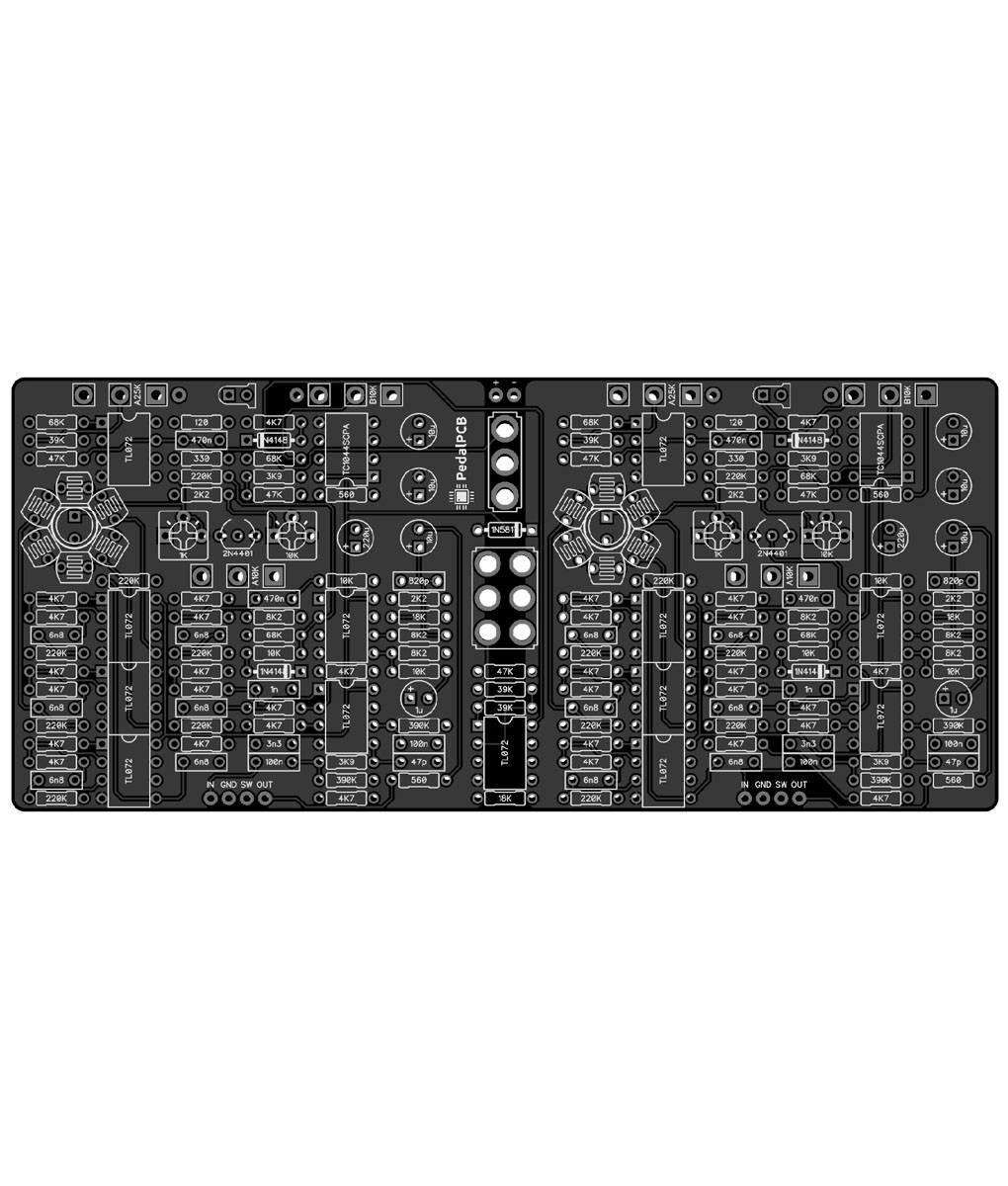

The Duo-Phase was inspired by the most popular features of the iconic Mu-Tron Bi-Phase.
- Rate A – Sets the LFO speed of Phaser A
- Depth A – Sets the LFO depth of Phaser A
- Feedback A – Sets the regeneration of Phaser A
- Rate B – Sets the LFO speed of Phaser B
- Depth B – Sets the LFO depth of Phaser B
- Feedback B – Sets the regeneration of Phaser B
- Sync (Toggle switch) – Sets the LFO syncronization of Phaser B (Normal / Reverse)
- Sweep (Toggle switch) – Selects the LFO source of Phaser B (LFO A / LFO B)
- Designed for a 1590XX / 6500 enclosure with top-mounted jacks
- Standard 9VDC operation (No special power adapter needed)

This is my 2nd review. This is a REALLY cool phaser. It’s a large build and it takes patience to put it altogether. Even for an experienced builder; expect it to take 3-4 hours.
I’ve build two of these now now. I built one a couple of years ago and sold it to my buddy. After a couple of years, my Phase 90 clone wasn’t cutting it with the “cool” factor so I decided it was time to build myself another one of these.
I couldn’t really find instructions for how to set the trim pots, so I thought I’d share my process in case anyone else isn’t sure what to do.
Do one side at a time. Set the rate to almost all the way CCW. Now adjust the 10K trimmer so that the light doesn’t quite turn all the way off. This will avoid any annoying ticking sounds.
The 1K trimmer seems to adjust how bright the LED gets. This will affect the overall sweep of the effect. Just adjust it to your liking. It’s best to do this in a dark room so the sound won’t change too much when you put the back cover on.
