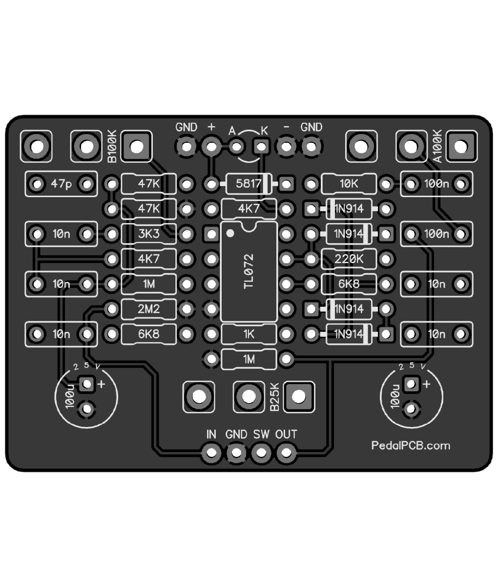

Straightforward build, great sounding pedal – very warm and vocal in the mids, but not in the usual congested way a tube screamer has. I found this circuit to be quite dark, so I swapped a few caps that I felt were bleeding off too much high end near the end of the circuit to brighten it up and it worked like a charm. Quite possible that the caps I had in it at first were out of spec, possible I made a build error, but either way it sounds fantastic now. Stacks incredibly well.

Very easy project. I’d recommend using a b100k volume pot as this circuit doesn’t have a lot of output, especially if you have the drive pot turned down. You can also replace the 220k resistor with something a little higher (390k or 470k maybe) for a little more dirt.

i finally get why people love the BB circuit. it sounds awesome. when i build another one i’ll swap the volume pot for the b100k as the other reviewer noted. this is a must-build!

This pedal sounds great if you take the mod advice above from Willis. Sub 220k for 470k. Sub vol pot for b100. I bread boarded this before getting the pcb. I thought it was quiet and needed a boost. With this mod you don’t really need a boost
