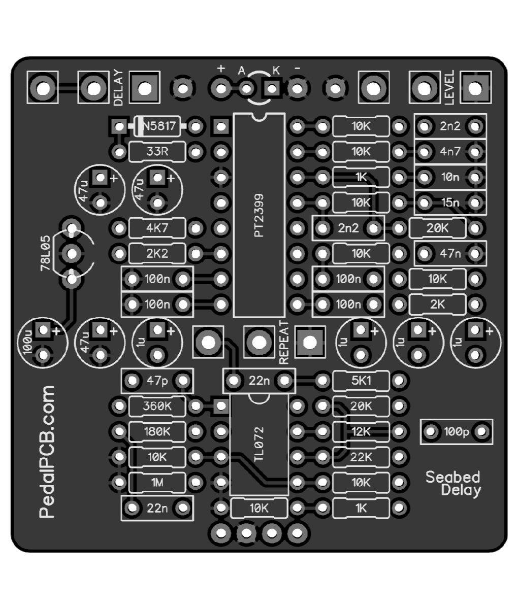

- Level – Controls the amount of delayed signal
- Delay – Sets the delay time (25ms – 450ms)
- Repeat – Adjusts the number of repeats

My favorite PT2399 delay board available from PedalPCB. The PT2399 chip is a quirky one and especially because it’s a cheap chip, I’d really suggest using DIP sockets and buying a few from different sources because the differences between two can be rather large.

Dustin Ozment (verified owner) –
