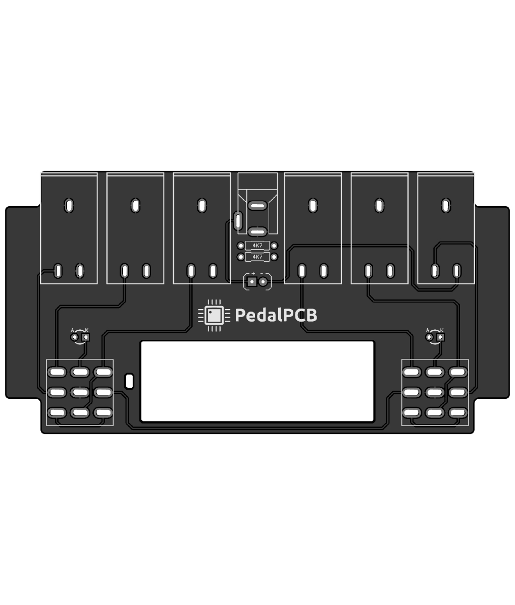

tcoffel (verified owner) –
Dual loop switcher? Check…. Easy and inexpensive to build….Check…… Does exactly what it sounds like it would do?….Check….. Read the forum and make sure you do the steps properly….You should definitely check…. (ask me how I know?)
There is an order to “installing / building” this pedal that will save you some headache… If you plan to use a 125B enclosure, you should do it this way BEFORE soldering:
Drill your enclosure
Place your jacks in the enclosure properly (pins facing bottom)
Solder your DC jack to the board
Solder the resistors and LED on the board (make sure the LED’s are lined up before making permanent placement)
Mount the board on the 1/4″ jacks that are already installed in the enclosure, THEN solder it all together..
If you don’t, you’re gonna regret it, and probably have to use a 1590BB enclosure to make it all work (this is just a REALLY good guess on my part, because I am a genius.. it’s not like this happened to me or anything, I swear.. no really, I SWEAR)
You can thank me later.. I accept gifts to my P.O. box…
