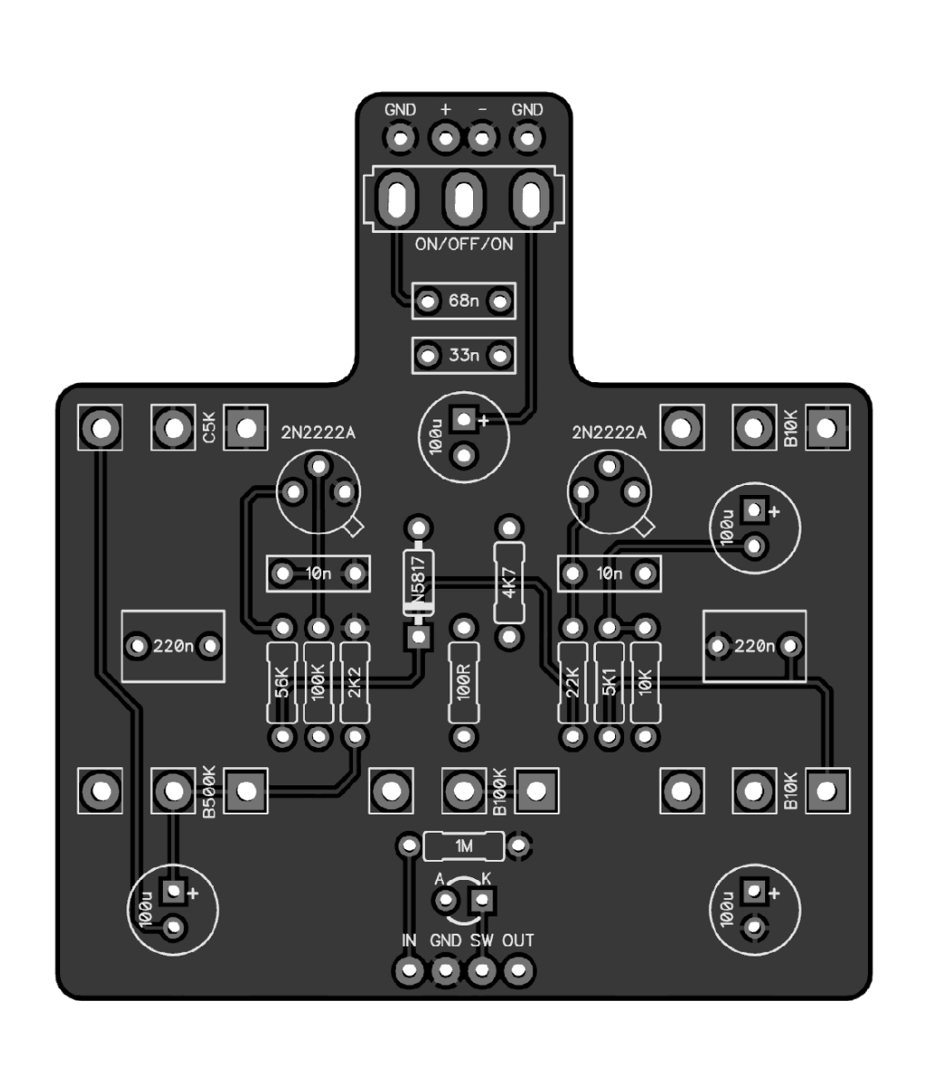

Love the sound when everything is dimed, but I find it gates too heavily. An internal trim would be a nice option to open this up a bit and get more sustain. It does sound fantastic and there are many different gated, fuzz tones, but it serves best just cranked. As always with PedalPCB, great quality, shipping and instructions.
Update:After building a couple, I tried socketing the Q1 and Q2. Had a few matched 500hfe (@5v) BC109C in Q2 and something magical happened. The circuit responded rather will without further modifications. Now this pedal is a 5 out of 5. May be the best fuzz I’ve ever played through.
