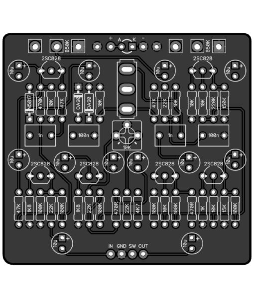

finebyfine (verified owner) –
Great octave fuzz. One of the best. Board is great as usual but pinout information for the 2SC828 isn’t easy to find online which can make substituting it (most any Silicon NPNs will work fine here) slightly more tricky than substituting other transistors. I believe the pinout as it is on the board, left to right, is ECB which matches 2N5088 and 2N5089 among others. Anyway – socket the transistors and socket the germanium diodes so you can play around with nailing down what you want.
